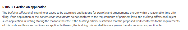

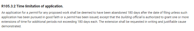

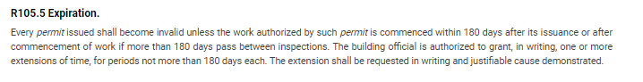

To add, the same language is in the 2021 International Building Code, Chapter 1, 105.3.1, 105.3.2, and 105.5.The application itself is good for 180 days; there isn't a timeline other than "reasonable" per the code. See references below:
Is that what you were asking? Btw, these were from the 2021 International Residential Code.
