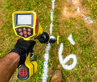

If you have a lot of land and are doing a lot of planting or other land disturbing work on your own, you could consider purchasing utility line detection equipment. For example, my dad uses this Schonstedt utility locator as part of his stump grinding business. It's expensive and won't technically satisfy the 811 requirement, but if you're doing a lot of work could save you lots of time while providing similar peace of mind as 811.

@Eric, that looks like a nice piece of equipment, and I'm sure it's handy, but it's way out of my price range. I can see why your dad made the leap, since it has great reviews.
