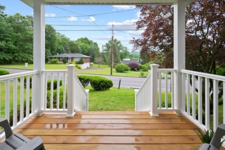

So this is an odd one. One of my friends in the past has replaced their main porch with another porch, similar in size. The first porch they received was from a neighbor when they moved in, never was permitted. They literally dragged the porch from across the street and that was that. Then that porch was starting to fall apart, so they ended up getting a similar sized porch from another neighbor and replaced it. They left the old porch next to the new one that winter and took it apart that spring. They never filed a permit for that move either.
My question is this, did they need a permit for moving the first porch over to begin with? Technically there was no construction or building, they just moved it from one area to the next. Same with the porch that replaced it. Each porch was similar in size as well.
