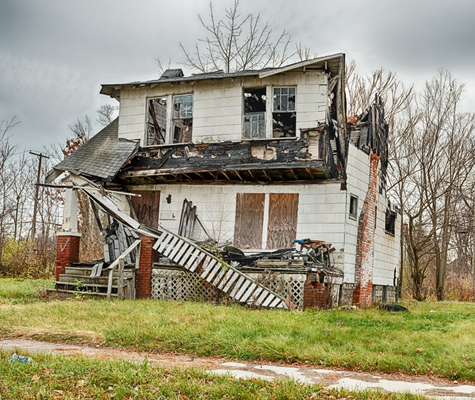

I was curious about situations where a homeowner has an old, dilapidated structure (e.g., a compromised garage) on their property, which represents a clear safety hazard to themselves, adjacent homeowners, and/or passersby. Oftentimes, these homeowners cannot afford to repair the structure and structure just sits there, only continuing to slide further into disrepair.
